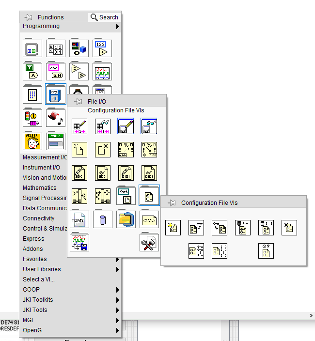

This is the way I find these VIs on my machine...
Greets, Dave
Message 12 of 37
(2,530 Views)
It's a VI Snippet, you can drag it and drop to the Block Diagram to get the code, then unhide labels.
Moreover, right clicking on any node, you can discover what's its parent palette.
Paolo

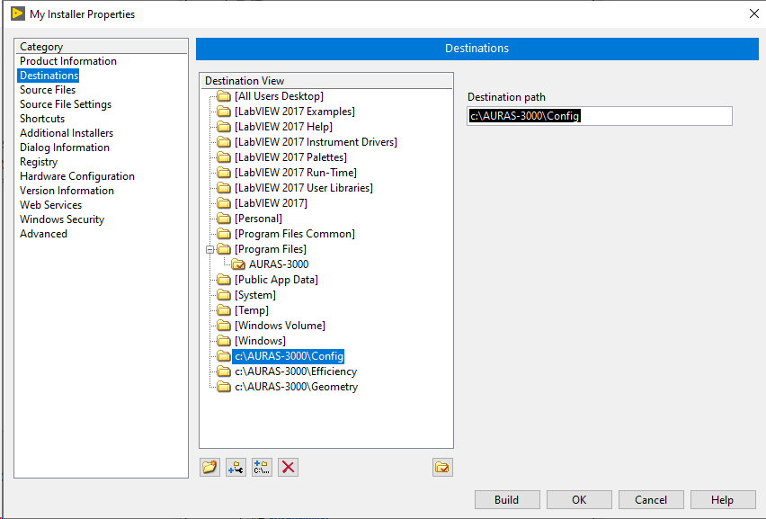

a) add a custom destination and copy your ini file therein; an example of custom destinations:Destinations.png
b) choose a directory, as in my previous example; when your program starts, if the ini file does not exist, create it using the Config Files VIs  (create also the directory tree if needed)
Paolo
LV 7.1, 2011, 2017, 2019, 2021
Message 15 of 37
(2,483 Views)

Hi Pincpanter and GredW,
Thank you so much for this information.
I am extremely sorry for so many questions but i am new to this and
a) I got your idea of  adding custom destination for needed *.ini file but I will have to install this      application(when done) in other systems so will that *.ini file automatically go to this custom destination when we install from Installer.exe??
b) Again with this also does not it look for the *.ini file (OR need to specify the specific location again with path build and required *.ini file might not  be there in this location in different systems(PC).
Thanks and Regards
Baig

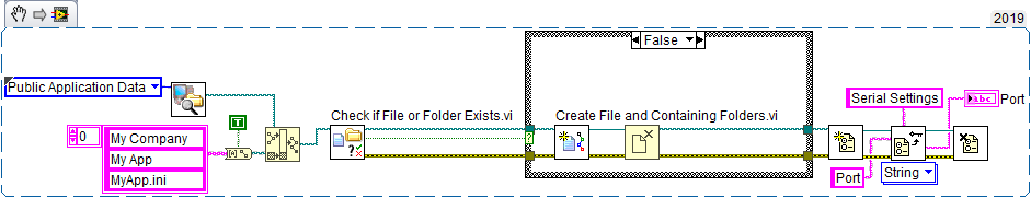

Hello Baig,
you are right, a) requires an installation of your *.exe on a new machine. With b) you are more flexible, since you hard-code the location into your program.
You can very easily check for presence of the *.ini - file, look at the snippet:
Btw. why doesn't work the snippet of pincpanther on my system (LV2019 32bit) ?? Am I the only one?
Greets, Dave
a) That depends on your program. 🙂 I usually do a check if the file exists and if not create a default setting file. Another option is to have an ini-file in your project and have it copied there through the Installer.
You can set the Open config file to "create if not found". You'd still have to handle the empty/default case though, but that should be easy enough.
b) see a)
