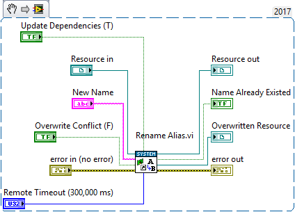

I think he meant that too Smiley Wink we don't need to set it.  We need to discover the address on the projects targeted system then align our project to use that discovered information.  I'll stand by my practice of aliasing the VISA Resource as a simple string (Of course, you COULD use an "Alias" string of "GPIB[n]::pd[:sa]::Instr" but that seams unwieldy to me for the developer to translate to a specific resource)
lets try that again the alias string has replaced a "Colon p" with an emoji but that shows just how much nicer it is to document and support a Alias like "MyProj_K2430SMU_1"

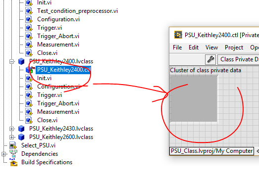

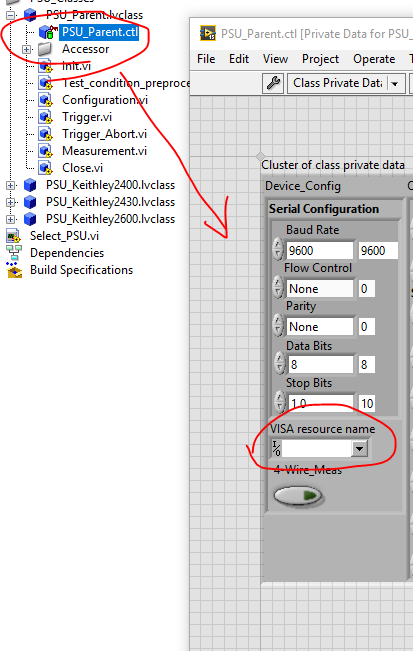

To clarify what is going on here is a bit more than what is shown.
and I left child class control blank to inherit from parent control
The situation is that, at different location. There are a few scenario where I need to change address for the child class. (maybe what I am missing is handling of child-class-control)

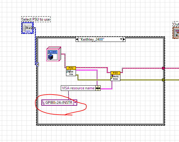

1. I am calling a child class that runs a default VISA address
       What is done now is like shown in above snips that I alter VISA address while initializing the child class. probably the worst way to do it for sure
2. The default need to be changed because the equipment at the given location is set to a different value, say 200 instead of 24 for existing system. Then I need to alter the VISA address to 200 to make it work.
Message 9 of 14

@jals:
I think that is exactly how all of us imagined it.
Mostly as it should be, except he clustering in the private data. The serial cluster is ok. Since it's a "standard" cluster it's almost like a class. The Device_Config is undesirable and redundant.
Give the parent two protected methods: set serial config and set visa resourse (or set GPIB address) and you're done.
