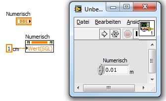

Hi Nathan,
Normally, via VI Server, it assumes the value being set is in SI units.
Which is nice as you minimize unit conversion problems this way!
Everyone should stick with SI units to avoid crashing space probes… 😄
Why don't you set the value using SI units in your BD? LabVIEW will convert automatically to the user-choosen unit on the FP:

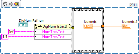

Yes, I understand your problem. Setting the same numeric text does not update value if new text is the same as old one.
Simple way is to extend numeric text up and set numeric.text property to INF. This resets value and second numeric text sets always updates value.

Accepted by topic author NathanJD
This works, if I understand your problem correct. First text resets value, second sets the one you need.
Property node is supposed to be linked to Numeric.
