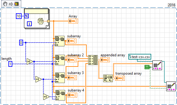

To avoid (our) eyestrain, do not attach pictures of your LabVIEW Block Diagrams.  We also cannot easily "modify" a picture, nor test its code, nor see "outside the edges" or "behind Case Statements".  Attach the actual VI instead.  Thank you.

hi tamartau,
please get rid of all the sub array, build array, transpose stuff
you get the same, just wiring the 1D array of your DAQ-read into the 1D-array-Input of the write-to-csv function
(to test yourself, drop the snippet onto a blockdiagram and run it)
