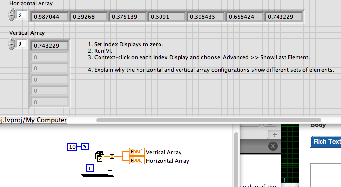

The pop-up menu item Show Last Element behaves differently for 1D arrays displayed horizontally or vertically with multiple elements visible.
The horizontal display shows the last k elements where k is the number of elements visible when k < N. The vertical display only shows the last element and k-1 empty elements.
See attached VI for a simple example. The VI was written in LV 2012 and saved back to LV 8, but not tested in any earlier version.

This is the behavior of the vertical display but not the horizontal display.
Generally the horizontal display behavior is what I want, although for the Add Elements to Array process the vertical behavior may be better.
Is this a bug (inconsistent behavior)? A feature? An unintended consequence of something else?

I would call it expected behavior.  After all LabVIEW arrays are (Row, Col.....) you see the last element in the last displayed row.  This should help keep the dimension order cleanly in your mind even if you display a row vertically.

I would also call this inconsistent behavior.  The last displayed row should contain the last row in the array.

I think I understand what your are saying, Jeff, but I thought that unlike MATLAB, LV considers 1D arrays independent of direction of display. Under that interpretation it seems like the same values shoud be displayed regardless of direction.

well, not exactly.  What happens when you add dimention to a 1D array or remove dim from a 2D?  a 1D array is a row.  Implementing a transpose with a vertical row display is problematic. And arrays must be rectangular since they are flat in memory.   That being said.  I wouldn't cry if the behavior changed.

I will not call this inconsistent behavior because it is consistent.  It uses the same formula in either case:  Last Index = Length - #cols.
While consistent, I do consider it wrong.  The formula I would choose is Last Index = Length - 1, for all dimensions.  Show Last Element should IMO put the last element in the upper left position.  I understand the appeal of the horizontal behavior, but I do not really like the idea of counting the number of visible rows and columns to determine the index of the last element.  Either way, it should be Length-1 or Length - Max(#rows,#cols), but not Length-#col

Often when I use Show Last Element, I want to see the values of the last element and several preceeding it.  I would prefer the lower right position as the one containing the last element.  If I only want to see one element at a time, I will set the display to show only one element. Of course that case has no inconsistency.

I filed CAR 389834 on this behavior. It is inconsistent behavior between the vertical and horizontal display. Since it is a 1D array, it should be only a visual difference and it should not be row vs column. I linked this thread to the CAR, but can you give me a bit of context of how this behavior affects your application? It seems like a cosmetic issue with low impact, so if it is impacting you more severely, I would be interested to hear about it.
