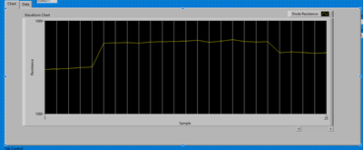

I'm trying to use a Waveform Chart to show Resistance(Y) and Sample(X) relationship. Because the resistance is very stable between samples, I basically don't see any grid on the Y-axis. No matter how I set the minor grid in the property, it just won't show. The only way it will show any kind of grid on the Y-axis is when I turn off the auto-scale and set max/min values on the major grid, but I don't get the resolution I like as the data will just show a flat line since the scale is so wide. Anyone can help with this?

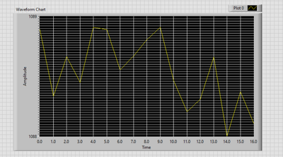

Thanks for your suggestions. I was able to mange the chart to show the minor ticks, but look pretty awful. 😞  I wish there is a way to specify the minor tick value in Waveform Chart. I will continue to play with the scale property to make it look better.

I didn't see it in the GUI right-click menu at first glance, but it's available via property node. Right click the block diagram terminal, then select Create -> Property node -> Y scale -> Range -> Minor increment. You can set that to whatever you'd like.
(That same submenu off Range lets you set the major tickmarks as well, FYI)

That works! in fact, it just allowed me to explore a whole bunch of other options for the chart. Thanks!
