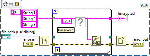

I don't understand what you are doing, nor why you are doing it this way.  The VI "SimplerEncryptiton" (should that have been "SimplerEncryption"?) is missing, but I'm guessing this is encrypting a string (of what?) multiple times (and writing each to a file, not sure if they are writing multiple lines or one long string), and reporting only the last one.
Here is a suggestion -- create an array of three strings, "String 1", "String 2", and "String 3" and use that as input.  Maybe re-submit your VI with the missing sub-VI so we can try it ourselves and see what you are seeing.
I don't have LabVIEW 2013 on this PC, so you won't be able to use this Snippet directly, but it is simple enough that you should be able to modify your own code (as I did) to reproduce this.Encryption.png

Since you are now dealing with binary data instead of text (after the encryption), you really need to right-click on the Write To Text File and turn off the "Convert End Of Line".

How interesting.  Two of us made specific suggestions, you followed neither of them, but did attach the missing VI.  OK, now go back and read (and think about, and be sure you understand) the earlier suggestions.
Do you understand the difference between an array of U8's and a String, especially when it comes to I/O?  Some of us are old enough to remember when NUL (0x00) was simply not written, and ^Z (0x1A, I think) would end the file.  And here you are inserting additional characters into an encrypted string and wondering why you can't decrypt it!
Go back, read our suggestions, do the "simple experiments" we outlined, and figure out how to do this correctly yourself.
