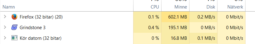

Task mananger shows heavy CPU load from simple program running for a week:
Task manager after a week
After closing the app Kör datorn and opening it again I get 0% CPU:
0% CPU after restart of program

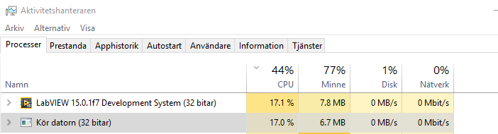

Yamaeda, now I've tested some more with leaving with Labview development system on for two weeks. Now the Labview dev system uses 17% CPU (about 1 core) and a small exe I wrote also uses 17% CPU (normally 0%).
Task manager showing heavy CPU load from Labview development system and small LV exe after about two weeks

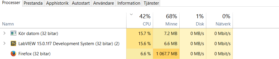

I pressed Stop on the "Kör datorn.exe", and that program still uses 17% when the program is stopped!
Stopped labview program still uses 17% CPU!
If I load a project in Labview dev system CPU load get lower during load process, and then goes back to 17% again.
I close Labview dev. "Kör datorn" at off state still uses 17% CPU.
If I close the app window also for "Kör datorn" and open it again CPU is back at 0%.
Starting Labview 15.0.1f7 again, that settles on a few percent CPU after a minute.
My guess is that some support code (Labview Runtime?) used by both the development system and exe files are causing this.
I've only seen it on a development machine, so it should not be a big problem in reality.
