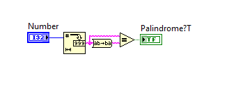

Below is one method of finding a numeric Palindrome.
Is there any way in which functions used can still be reduced. I have tried with T/F strings, mathematical approach and applied further more logic's. But, at max 3 functions were used in all of those, whereas the requirement is 2 functions.

Hi Priyardarsini,
finding a palindrom is quite easy:
check.png😄
Your VI is checking an input for a palindrom…
What's the point in reducing the number of used primitives?

I guess your might e.g. want to use a loop and find all numbers below a certain upper limit that are palindromic when formatted as decimal. (of course you could also try to find palindromes in hex, octal, or binary formatted numbers, etc. these are probably easier)
I don't think you can get "simpler" than what you show, but you might get faster. 😄 (not sure though)
One interesting way to do this would be all blue (i.e. without any pink wires), so try that. 😉

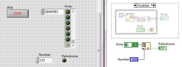

Given a reasonable upper limit and sufficient RAM, you could just use a lookup table 😄
Just a challenge!!
on Optimizing the Task..
Every single logic can be further minimized with LabVIEW, in that perspective.. it is always possible.
Comeon Gerd, we may find a new way of checking an input for a palindrome !!
Smiley Happy

Hi Priyardarsini,
"Optimizing" a VI ("algorithm implementation") most often is a trade-off between speed and disk/memory requirements. You need to define the kind of optimization you need to achieve!
As you requested "less functions/primitives" you should follow Christians suggestion on using a LUT: it apparently only uses just one primitive and is quite fast too. The trade-off here is memory consumption (and pre-compile preparations)…

And can you just brief the LUT concept, please.. 🙂
The LUT (lookup table) is a boolean array that for each element knows if the index pointing to it is a palindrome or not. You can generate the LUT by placing your original code inside a FOR loop, wiring [i] to the input, and auto indexing the boolean at an output tunnel. When done, convert the indicator into a diagram constant, copy it, and implement my code in a new VI. Change the "data entry" for the numeric input (wired to index) to coerce to the valid range of numbers, i.e. the size of he LUT.
