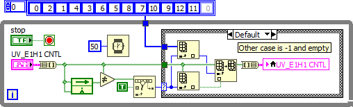

Note that if you want to eliminate the event structure and do polling instead (Maybe this involves hardware), it's not really more complicated:

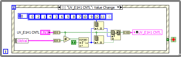

@altenbach wrote:
Here's what I would do:
This solution is exactly what I was looking for.  I wanted to integrate this into my existing from Panel UI Event structure loop anyway. This solution couldn't be better.
Wow I am just still in awe at how simple but effective you made this code.  Thank you again.
One small note here:
The code will work fine as long as the user is the only one interacting with this control. If you plan to ever fire this event using a signaling property node, be aware that old and new can be the same or differ by more than one element. If this is a concern, you need to add some code to deal with these possibilities.
Message 7 of 8
(4,545 Views)
Thank you.  Thankfully this will be driven by a single HMI by one person.  We shouldn't run into this issue.
