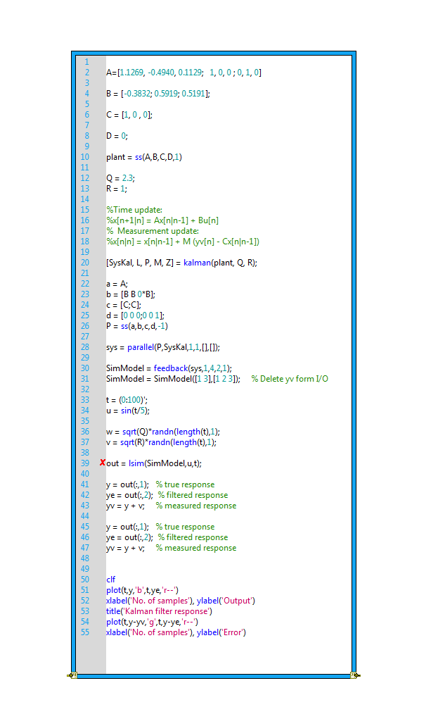

I am trying to follow a example from MATLAB using Mathscript Kalman Filter Design
When I run the code, it shows "Error in function lsim at line 39 column 7:  The inputs to this function must be scalar." but I have no idea how to fix it. Any help will be appreciated.
A=[1.1269, -0.4940, 0.1129;   1, 0, 0 ; 0, 1, 0]
B = [-0.3832; 0.5919; 0.5191];
C = [1, 0 , 0];
D = 0;
plant = ss(A,B,C,D,1)
Q = 2.3;
R = 1;
%Time update:
%x[n+1|n] = Ax[n|n-1] + Bu[n]
%  Measurement update:
%x[n|n] = x[n|n-1] + M (yv[n] - Cx[n|n-1])
[SysKal, L, P, M, Z] = kalman(plant, Q, R);
a = A;
b = [B B 0*B];
c = [C;C];
d = [0 0 0;0 0 1];
P = ss(a,b,c,d,-1)
sys = parallel(P,SysKal,1,1,[],[]);
SimModel = feedback(sys,1,4,2,1);
SimModel = SimModel([1 3],[1 2 3]);     % Delete yv form I/O
t = (0:100)';
u = sin(t/5);
w = sqrt(Q)*randn(length(t),1);
v = sqrt(R)*randn(length(t),1);
out = lsim(SimModel,u,t);
y = out(:,1);   % true response
ye = out(:,2);  % filtered response
yv = y + v;     % measured response
clf
plot(t,y,'b',t,ye,'r--')
xlabel('No. of samples'), ylabel('Output')
title('Kalman filter response')
plot(t,y-yv,'g',t,y-ye,'r--')
xlabel('No. of samples'), ylabel('Error')
