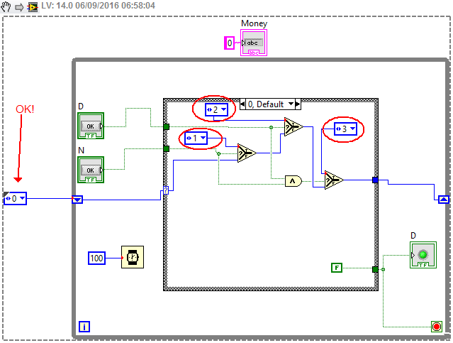

I am a beginner in LabView. I tried implementing the following example : https://www.ni.com/en/support/documentation/supplemental/16/simple-state-machine-template-documentat...   to learn the state machine implementation. But the simulation does not seem to work though I have followed all the steps. What could be the possible reason? I am attching the screen shots of the connection I have made.

You should attach your VI, not screenshots if you wanna get quick help! Since you attached simple pictures, I can only guess: I see coercion dots at the Select function inputs, are you sure all the Enum constants are the same? Even if the mentioned example does not do that, I would recommend you to use (and learn what it is) Type Definied Enums ( https://www.ni.com/docs/en-US/bundle/labview/page/creating-type-definitions-and-strict-type-definiti... ).
What is the mechanical behaviour ("Mechanical Action", right click on the control) of your Boolean controls ("D" and "N")? You should use "Latch When Released" option, and not one of the "Switch" type, so when your VI reads the value of the controls, they will reset to their initial state.

Hope Blokk has given enough information.
Try to make sure you are using TypeDef enum for case selector, so that you can modify the elements of enum at anypoint of time without any errors, else you will have a enum with different elements or you need to map with original enum after every change.

Thank you for the reply. I have attached the vi, please help me proceed as I am not able to debug.

You are getting closer. You have already created a TypeDef Enum, the one you have it outside of the while loop. However, you have to change ALL the enums in your VI into this typedef enum!! See the little black triangle symbol on the typedef enum icon on the Block Diagram? You should see that on ALL enums in your VI.

Thanks for that. I changed all enum to type def., but there is no change, I dont see value in the money change when I press N or D . The dispense is also not happening.

You did not listen. You have still "Switch" mechanical action for the two Boolean controls. Change them into "Latch When Released".

I am using the latch when released action for my switches from the beginning. I don't think thats the problem.

After changing the mechanical action for the "D" and "N" controls, the VI works for me...
edit: did you change the Enums in ALL cases of your Case structure???
edit2: I hope you use the SAME type def enum for all enums in your VI, and you did not create a SEPARATE type def for all each enums? 🙂
Edit3: Added the missing Typedef control... as a next step, you could learn about LV projects, a useful (must one) way to keep corresponding files together (and much more) 🙂
