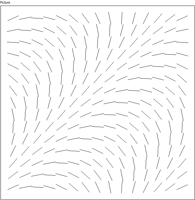

How do I draw rotating matrix of lines, like in the picture, in real time?

To be honest I'm new at Labview programming, so I couldn't make anything. Thank you for your advice. I attach my programm below. It's main goal is to simulate the Freedericks transition and the drawing is only a part of it.

Thank you very much for your help. I actually watched a tutorial which led to my solution. By rotating a line I meant changing its direction by a given angle. I attach my solution below which requires a matrix of angles and later on draws those "molecules" with a given orientation on a 2D plane. The only thing I can't change is to resize the 2D picture indicator to fit it to the size of the "matrix of molecules"

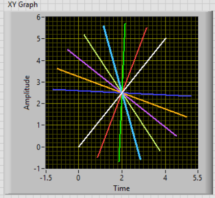

I decided to "play" with this a little.  I defined a Point as a Cluster of X, Y, and defined a Line as an Array of Points.  In this example, the line has only 2 points.  I wrote 5 very simple sub-VIs that did only one thing --
  • Shift, translates a line by adding a Point offset to each end.
  • Centroid, returns the middle of a 2-point Line.
  • Rotate about Origin, rotates a line about the Origin.
  • Rotate about Centroid, rotates a line about its Centroid.
  • Line to Graph, converts a Line to a format (Cluster of X Array, Y Array) suitable for plotting on a LabVIEW Graph.

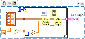

Here's a Demo that takes a line from 0, 0 to 4, 5 and plots it rotated by 8 multiples of pi/10.  Here I plotted all of the lines so you could see it "statically" -- I can also plot it "dynamically" by moving the Graph indicator inside the For Loop, and see the line rotate.
The original line is in White.

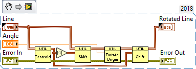

A key to getting this to work with relatively little effort was breaking it up into such simple steps that "(almost) nothing can go wrong ...".  Here, for example is Rotate about Centroid -- I'll leave the rest as an Exercise for the Reader.
One final note:  instead of using Matrices, I used Complex arithmetic.

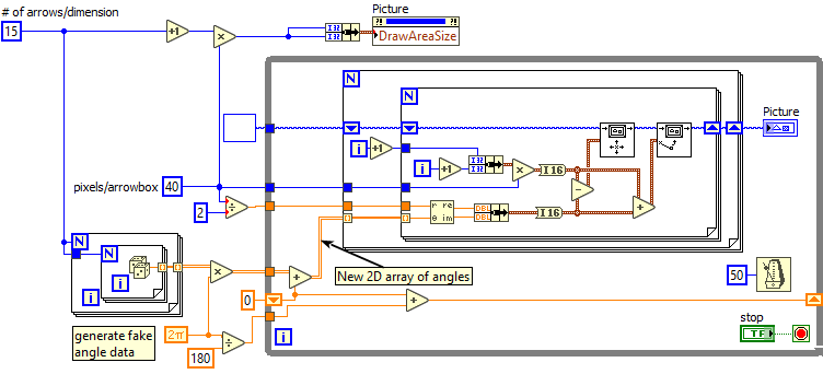

If you use complex datatype, you don't need any trigonometry (sin, cos, etc.). Here's a very quick rewrite of my mentioned old example that can hopefully give you some ideas. This really does not need much code at all.

And here's how the code could look like when operating on a 2D array of angles.
