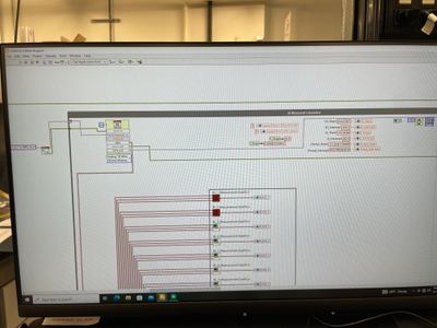

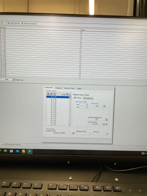

So I have close to 114 channels.
120hz 1sample
 Then, I have 60 sample and my loop in set to update every second. But it’s too slow.
(1,095 Views)
Pictures are useless (particularly when they cross scan lines and are rendered unreadable.  The 9205 only has 32 Single-ended Analog inputs, and if the A/D is set up correctly, should easily be able to handle sampling in the kHz range, so 120 Hz should be trivial.  If you need to run 4 9205s simultaneously (to handle 128 channels), this should add a few microseconds to the code.
If your code can't do that, either there's something serious I've missed about the Hardware (I've never used these modules, am only going by their Specifications) or you code is hopelessly bad.  Write a small Demo Project that tries to take a few samples, preferably in LabVIEW 2021 or earlier.  If you don't have such a version, write it in LabVIEW 202x (32-bit, please) and "Save for Previous Version" to 2021 or 2019, and we'll look at it.
Bob Schor
(1,076 Views)
