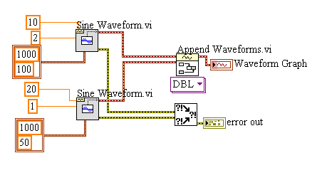

Hello srikrishnaNF,
Thanks for the solution. But the issue is I just want to append one cycle of a1,f1 and one cycle of a2, f2. f1 and f2 could be DBL. Let me know if you have a solution. I shall appreciate it.

I would make an array for your amplitudes and frequencies.  Use a FOR loop to create the waveforms and concatinate.
Message 7 of 8
(3,239 Views)
I just realized what you were asking for.  Sorry for the misinterpretation.  See if this works for you.
