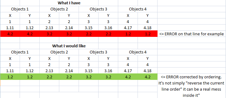

I'm currently facing a problem in LabVIEW array manipulation.
I'm using LabVIEW Vision VI called "IMAQ Count objects".
It's extracting me the XY of each objects at each frames. However, it doesn't track object frames by frame but simply "randomly" extract XY of each object on the frame.
This is why I would like to be able from row to row, to order every time each point by the previous closer one.
As it's not really easy to understand and my english level isn't good enough, here is an example done in excel :
 Also,it's not simply "order every number" by ascending order, but it's XY coordinates.
I've also created a VI, in which I'm able to get :
- Difference between each X and Y at each frame
- From that, the distance between the 2 points
- Then order it by ascending order.
Maybe it can help ? So, I've attached my VIs.
Start OrderXYbyClosest.vi and put Distance2Points.vi in the same folder.
Please, don't say me it's a "Vision" problem, it's just array manipulation here that I want to do, not request a Vision feature 🙂
Thank you very much,
Sébastien

Hi daveTW,
I'm sorry but my english level is good enough to correctly explain the problem, because even in my mothertongue, this isn't really easy to explain. I did an other example, this may be more helpful and understandable.
Hope someone can understand my problem 🙂
Thank you,
Sébastien
EDIT : But yes, I want to sort XY coordinates by closest row by row, but I'm just not able to do it 😞
The distance between 2 points isn't an important step if you can solve it in a an other way, but it was just an idea that might help to solve my problem?
I thought that the first step was to know which XY was the closer to the previous row XY; but there is probably an other way to do it.

Of couse. Here is one with 3 objects and more coordinates. I've "created" it (from several different data I had).
One csv as requested - EDIT : I don't know why I'm not able to attach the csv one. Can you open the XLSX and save it to csv by yourself?
The same XLSX with the problem appeared highlighted in red.
As you can see, the VI scan each object starting from left to right (X axis), but if for example, the object #1 goes more to right than object #3, then object #1 will have the coordinates of objects #3 and vice versa.
I'm still working on your complex idea. I've even found this interesting VI https://www.ni.com/docs/en-US/bundle/labview-api-ref/page/vi-lib/analysis/polynomials-llb/sort-compl... but I still have problems.
Sébastien
