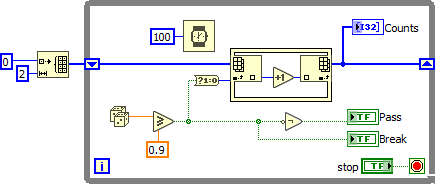

Your random number is between 0 and 1, so you want to multiply it with a reasonable number to even get to 9. (Never do "equal" comparisons on floating point numbers).
All you need is wire the scaled random number to the comparison and add a 1 to an integer held in a shift register whenever the comparison is true. From the total number of iterations you can calculate the number of failed comparisons.

Here is one possible solution.
