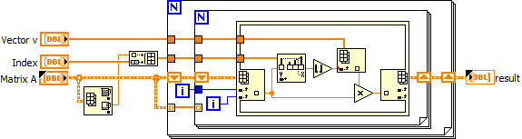

Accepted by RaphaelMT
It seems like simple array operations in a loop.
Go through 2D array element by element replacing each element after you've looked it up in the limit table and use that result with the v table.
I concatenated a 0 element to the front of the index or limit array so that threshold 1-D array rounded down will yield the correct index in the v array.
Message 5 of 10
(5,379 Views)

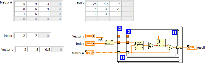

I got something similar. Be careful if the matrix can contain negative numbers/thresholds, though. Use -inf as the first element.*
(I probably would use the IPE on the matrix directly, though)
*EDIT: -Inf does not work right. Use a value smaller that the smallest matrix element as first element if the index array. See below.
Message 7 of 10
(5,367 Views)

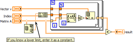

That's how that could look like (same result):
