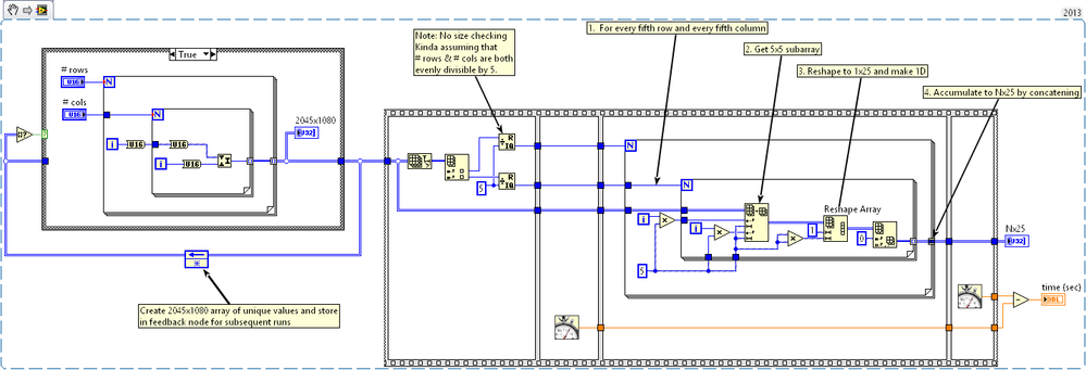

My first thought was to group those 5x5 subarrays of unique filter id's and work from there.
There are probably more optimal ways to approach this problem, but the stuff I tried below ran in ~50 msec on a several year old desktop PC.   [Edit: changed display format of array contents to hex since values were generated in a way that makes more sense to see that way]

A couple followup thoughts:
1. The code I posted ended with an Nx25 2D array.  Each column should represent one of the 25 subsets you want.   Or you could transpose it to 25xN because then you could auto-index a For loop over these 25 subsets.
2. For your real app, it may be more efficient to pre-process the *pattern* of this rearrangement into an "indice mapping" array.  Then the real time processing isn't trying to create and reshape 2D arrays, it just maps data elements from the original layout into the layout you want.
Let's say:
I is the 2045x1080 array of raw Image data
M is a 25xN array of mapping indices (here N = 88344 to account for every element)
D is the 25xN array of image data after rearranging.
The mapping indices found in M would let you do  D(i,j) = I( M(i,j) ).
Then you could auto-index 2 nested For loops with the pre-defined M array and auto-index D on their output tunnels.
I'd expect this to be faster, but you ought to check it out rather than assume like me.  (Plus, someone else may post a different and altogether more efficient solution).
