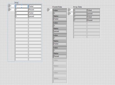

Please see the picture,
Thanks for your help,

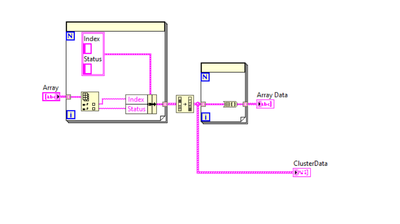

There are multiple ways to achieve, please find the one quick approach.
Palanivel Thiruvenkadam | பழனிவேல் திருவெங்கடம்
LabVIEW™ Champion |Certified LabVIEW™ Architect |Certified TestStand Developer
Kidlin's Law -If you can write the problem down clearly then the matter is half solved.
Message 3 of 9

Hi tnn,
@tnn wrote:
However, If I follow that, I still cannot split the array,
It always helps to simplify a VI:

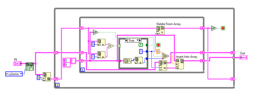

Hi tnn,
why can't you "split the array"?
Which error do you encounter?
Where are you stuck?
(Why did you need to use OpenG?)
Suggestion:
Message 7 of 9
(3,069 Views)

Here's what I would do (you can skip the sort if you want the output sorted by first appearance of the key):
To get each of the three grouped arrays, just index into the output and unbundle.
