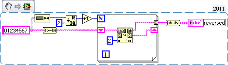

Reverse String + For Loop + String Subset. Put them into VI, mix, cook for three minutes.

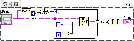

You mean something like this?

If you check his comment he doesn't want it reversed, does he?

strange but from string 1010002 i'm getting only 00 02 using the last methods.
Message 5 of 15
(5,289 Views)
sorry my mistake, last method works just fine. thanks a lot. 🙂

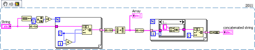

may be in the same topic i can ask another question - how to assemble the resulting array 1 01 00 02  with dots - like 1.1.0.2 ?

Here you go. The 0 case is empty

Splendid. Thanks a lot.

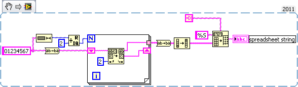

I would do it this way. (wait for Christian to get much simple logic)
You can change the delimeter in whatever way you want.
