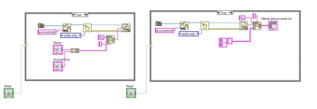

I have to make a VI that does the job of storing information in a text file, with a row containing user's name (column 1), and say account no (column 2),
how do I move on to next row, in the text file after the user hits 'write' ? ive attached the vi.
can anyone please help ?

maybe you should think about appending new data to an already existing file?

Thanks for a prompt reply,  I want to be able to append the new data when user hits 'write' each time, appending would mean the new data moves to new line (row), like column index +1 for every write. how do i do that?

Hi Sono,
you should append new data to the file instead of overwriting it.
There are examples coming with LabVIEW that show how to do that...
(2,675 Views)
Thanks, this solved the problem 🙂
