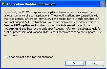

You need to disable the SSE2 optimisation option in your build properties as you are running on a cRIO 9002, which is an older model that does not support this feature:
http://zone.ni.com/reference/en-XX/help/371361H-01/lvconcepts/sse2_caution/

Thank you very much.... Problem got solved.
Disabling SSE2 Compiler Optimizations
Pradeep Kumar Achu
