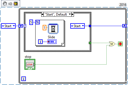

The attached VI does not stop after the VI reads the Stop. It stops after finishing the next loop. Why? I wish to stop the loop right away after the Stop button is pressed or at least after the VI reads the Stop button. How can I do that?

If I slightly re-arrange your diagram like this...
Does that make the problem more apparent?

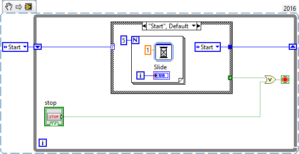

If you couldn't guess what I'm getting at, LabVIEW will parallelize any code that it can. In this case, there is no data dependency between the case structure and when the stop button gets read.
Odds are, the VI is already waiting when you press the stop button - but the stop button has already been read in that iteration of the overall while loop. There are a couple ways to solve this:
1. Put the reading of the 'stop' button after the case structure executes using data dependency (aka sequence structure)
Cons: If the code in the while loop takes a long time to execute, it could appear that the stop button isn't responding to UI events as it will take a few seconds for LabVIEW to read the state of the button.
2. Have an event structure in the while loop and make the state machine check for events or wait at the event structure when idle (look up the State Machine sample projects or the JKI State Machine good examples of this)
3. If this will eventually turn into a larger application, consider looking at the Queued Message Handler, where you can completely de-couple your UI handling with the processing
-Nate
