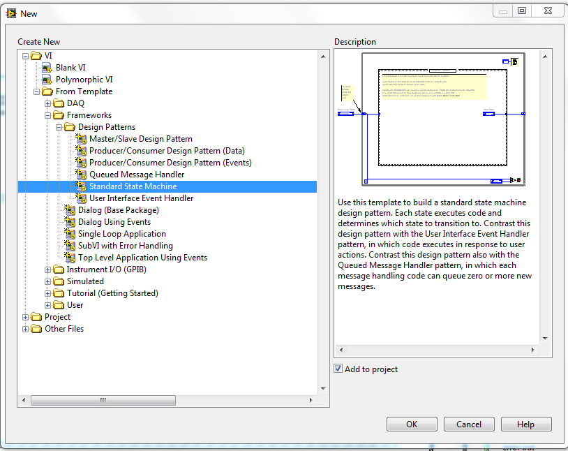

Edit: I just opened my LabVIEW 2016 window, and clicked on "create project", and the State Machine is there, plus the more advanced templates:
Message 2 of 11
(7,058 Views)
2010-2015 it'll look like this:
My favorite/go-to pattern is the Event driven Producer/consumer.

It's still there in LabVIEW 2016, but is no longer located under File, New ..., From Templates.  It is now under the New Projects button on the Welcome Screen when you start LabVIEW.  In addition to the Simple State Machine (see picture in Blokk's earlier post), there are several "more complex" Templates and Sample Projects (such as the Queued Message Handler, a State Machine + Producer/Consumer, in a way).
There's also the JKI State Machine in the LabVIEW Tools Network that you can find by firing up VIPM which has been bundled with LabVIEW for at least the last 4-5 years.
State Machines are still Alive and Kicking in LabVIEW.

Thanks to all replies. My Labview version (2015) does not have the standard state machine template, for some reason. I have two separate installations and it is missing in both. Go figure.
Bill Linares
Message 9 of 11
(6,889 Views)
It is not found under File->New..., you need to click on the Create Project.
Or start using some of the other templates, like the Producer/Consumer Design Pattern (Events).
