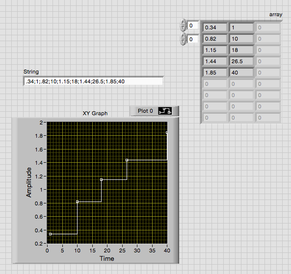

Is this what you want?
The attached VI uses the suggestions which have been posted along with a few modifications I added to implement this.

Johnsold,
You literally are the man. This is exactly what I was going for thank you!
