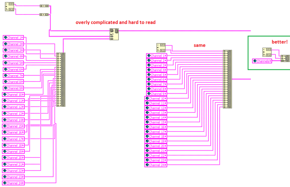

Whatever you are doing has nothing to do with excel. All you are writing is a delimited text file. I am also not sure why append=TRUE when writing the column headers.
That said, I agree that this code is absolutely horrendous (counters in floating point representations, stacks and stacks and stacks of stacked sequences, 24 ordered scalar globals where a single array global would work equally well. Peppered with Rube Goldberg constructs everywhere. Properly written, the entire thing could fit on a postcard and contains no stacked sequences and Locals&Globals.

@PH196 wrote:
I know there is a more a efficient way of writing this program, but this is what I have at the moment and don't have time to start completely from scratch.
Do yourself a favor and take the few hours that it would take to at least learn some LabVIEW basics. You don't have time to waste on code that may never work because you don't know how to use the tool. You will finish this task much quicker by learning to do it the right way and starting from scratch.
I started looking at your code but got lost with what is even the top level - the one labelled main does not appear to be the main.
@PH196 wrote:
I'm unfamiliar with the state machine structure, due to my limited experience with labview; but is there a reason why you don't want to use global variables to do this?
In the right context global variables are not bad, but most people who have limited experience with LabVIEW run into problems using them, and most veteran LabVIEW users rarely use them. It is easy to abuse global variables and create race conditions (parallel parts of the code are accessing the global variable at unexpected times).
@PH196 wrote:
I tested it and was able to read/store values to each global variable from an external circuit with a changing input voltage (changing thermistor resistance). I chose the DAQ assistant because its easy to configure the pinout.
If I have 24 values which represent 24 samples, 1 for each line, all stored in global variables, couldn't I just bundle them into an array and write them to an excel sheet?
Why put them in global variables at all? The data are held in the wires - just use the wires to get the data where you need it. Of course to do that without making spaghetti you need to learn some LabVIEW. A state machine is a very simple design pattern - learn about it.
To be fair, the code outline wasn't necessarily my idea, I just took a bad outline and likely made it worse.
This is for an undergrad EE project, and as previously stated there was no background training or guidance given on how to use labview hence: using stacked sequences to control program flow.
I think what would be most helpful would be to explain how this project can be simplified using the state machine design.
