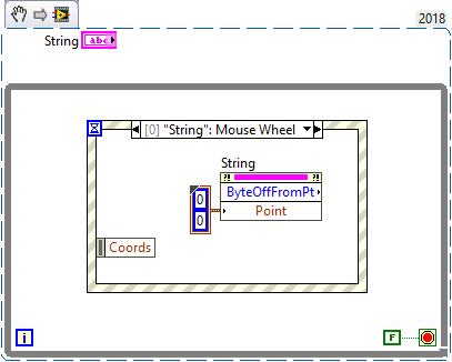

Here's a real workaround:
You can (tested) also put the method in a callback even, if you don't want to add complexity to your main vi.
