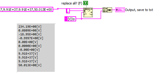

Way too many remaining questions to give a definite answer.
  • As has been said, your format (%s) is wrong and LabVIEW will silently substitute %f instead, which is not desirable, because your "9.91E+37" will turn into a "99100000000000005200000000000000000000.000000", which is unreadable. Nobody will take a magnifying glass and count all these digits to make sure what it is. You need to decide on a reasonable better format!
  • Do you ever need the numeric array at all? If not, all you need is replace all commas with e.g. "[V}<\n>" No need for the expensive detour over anything orange. (see picture)
  • It is not clear how you decide between unit letters [V], [A], etc. Does each field have dedicated units or are all units the same for each reading?

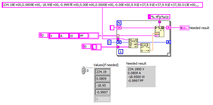

Hello
Thanks for the answer. On screenshot I am showing what kind of results I want to achieve and what kind way of working to avoid. I hope this is clear view of my way of thinking.
Dawid

"%.4" is NOT a valid format!
Message 5 of 10
(3,726 Views)

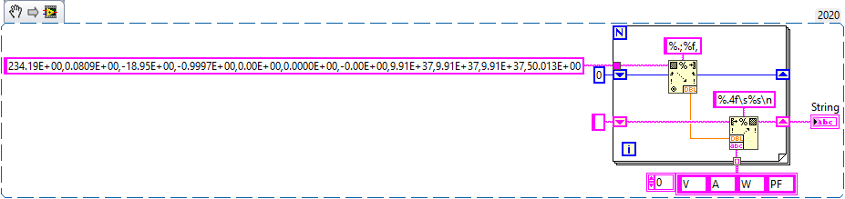

Accepted by topic author mrspock
try this:
Message 6 of 10
(3,723 Views)
@mrspock wrote:
Hello
Dawid
Here, have a look at the attached example.
If you really only need the first four values, here's another alternative. No need to parse all these extra characters.
Message 8 of 10
(3,713 Views)

I'd go for:
Note that these solutions are not simpler per se that your original post.
They are maybe (doubtfully, Spreadsheet String To Array is blazingly fast) a bit faster, but they leave out half the problem (storing to file).
Message 10 of 10
