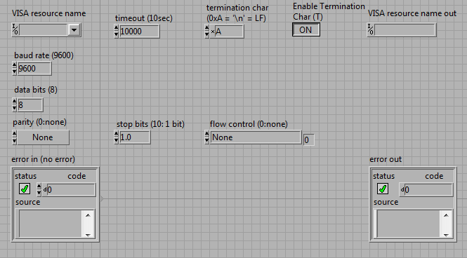

I don't want to share the diagram because its very extensive, so I'll show you the pieces of diagram and a brief explanation of this pieces (I'm sorry for not being clear)
First of all, this is for my school project, it involves sending g-codes to a cnc machine via serial communication to an arduino... for this I'm using VISA to communicate (inspired by this http://embeddedlaboratory.blogspot.cl/2016/08/serial-communication-using-labview.html)
The thing is that, if I send a very large G-Code, the code cuts in some point... I don't think that theres a limit in the string control (by the way, i don't send any weird character or something), but my suspects are that the VISA block has the problem
ps: i'm working in 115200 bauds.

As suspected, you activated the term char for read and set it to \n = LINEFEED. If your arduino has similar settings, then that might be the problem (depending on your arduino code), because I strongly suspect, that g-codes at some point will include some linefeeds.
Does "VISA Write" throw any errors when sending a string? How do you detect that you have a problem at all?
Regards, Jens
