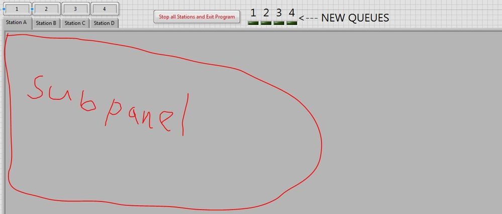

Hi All,
I am starting 4 VIs with Async call and inserting each one into a subpanel in 4 tabs (each tab has a subpanel).  It is the same VI I am using 4 times.  The VI has a waveform chart in it.  When tabbing through the 4 tabs, the waveform chart in each subpanel resets and starts plotting new data as soon as I tab into it.  Any idea why?  All other parameter/timers/counters do not reset and run asynchronously as expected.

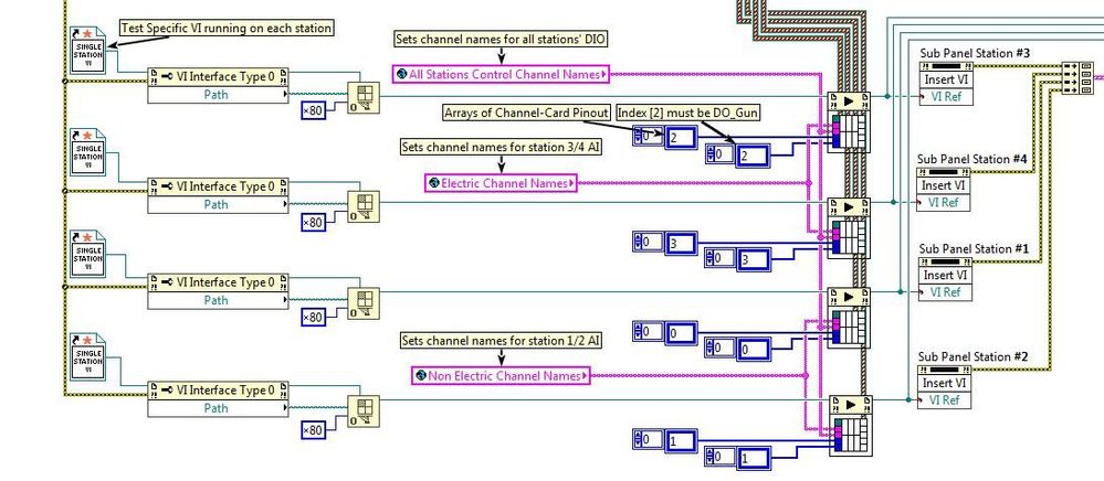

Scarce little to go on but I will throw out an idea based on the fact you said you are using a Waveform Chart and I see globals in the code.
A chart that uses a Waveform data type will reset (clear the plot) and start plotting from the beginning when ever a new update is not consistent with what is already plotted.
Examples;
The channel names change
The T0 of the new data is older that data already in the chart
So if your tabbing is introducing a timing issue that results in the charts getting a new set of channel names or old T0 timestamps... it would explain what you described.
You may want to skip putting them in the subpanels and just showing the FPs to see if that make a difference.
