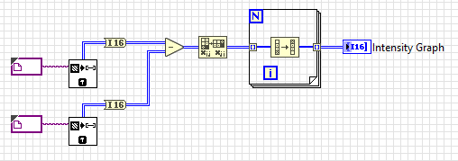

Did you do it like this?  Make sure you set the Intensity Graph to Autoscale Z.
Randall Pursley
