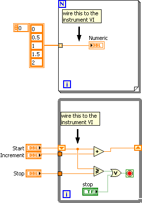

If the instrument does not have a sweep function, you can just step it through the loads you want in a loop. There are several ways to do it. Simplest is to just have an array constant wired to a for loop. You could also generate the array with the Ramp Pattern function. You could also use start, stop, increment controls. There is also a shipping example called Frequency Response that uses a for loop and a formula node.
