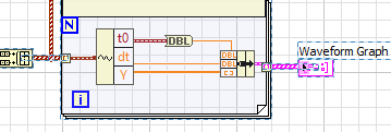

I think I understand your problem.  The Waveform Graph doesn't display things with the right delta t right?  That makes sense from the help file Displaying Multiple Plots on Waveform Graphs
Convert the array of wfm to array of cluster of x, dx, y[]
