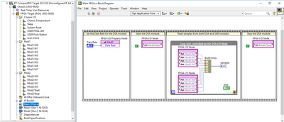

I am currently trying to acquire acceleration data from a sweep using both the NI 9234 for an IEPE-sensor and the NI 9220 for an analog MEMS in a cRIO 9036. The data should simply be called on the FPGA side using the same FPGA I/O Node, put into an array and fed into a FIFO.

Now i added a Discrete Delay to my FPGA. This only leaves me with two questions:
1. How could i compensate for the non-integer delay of the NI 9234?
2. In the example of the article above, the data is called from two separate FPGA I/O Nodes but from what i read it would be better if i read from only one Node instead. Which is better?

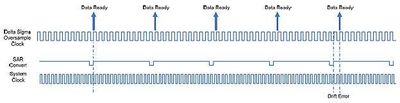

In this article by Salvador Santolucito of National Instruments, he talks about the Clock Drift Error when Synchronizing SAR and Sigma-Delta ADCs.
He states that:
"One method of overcoming the drift is to trigger the SAR conversion on the data ready signal of the sigma-delta ADC. This will synchronize the two measurements and prevent them from drifting apart over time. Depending on how this is done, jitter may be introduced into the SAR conversions. If the system (running off of the system clock) samples the data ready signal and drives the convert pulse, there will be jitter on the convert pulse on the order of one system clock period. This is because the data ready signal is coming from the oversample clock domain.
A better way to synchronize the sigma-delta and SAR ADC is to use the same clock for both ADCs. This way, the timing engine that drives the SAR conversion will be synchronous to the oversample clock going to the sigma-delta ADC. However, this solution has several downsides. The clock speed needed for the sigma-delta is often much slower than what is needed for the communication and timing engine for the SAR ADC. To get around this problem, you may be able to use an FPGA to phase align the two clocks, but this is a complex and difficult design that is only needed if you require precise synchronization."

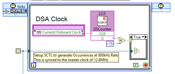

Don't have LabVIEW here, so trying to remember what I did, will post later after some meetings. This is how I remember I synchronized a SAR and DSA card in FPGA.
Look for the "Binary Counter" function that can be reconfigured with a built in reset.
Using that function in a SCTL you can count pulses of the master clock for the Delta-Sigma module. Use this counter to generate an occurrence every Nth cycle to start data acquisition on the SAR module in another loop. You will still need to compensate for delay, but since the modules are using the same clock, they should drift together. So your SAR sampling rate will be some integer multiple of the master clock, which may or may not correspond to the sampling rate of your DSA module.
I will try to post some images later today when I am in the office.
mcduff
Message 6 of 32
(7,718 Views)
Accepted by topic author LReck
Here are some pictures that will hopefully help you.
In the the figure below, I have a SCTL that is counting pulses from one of my DSA Sample clock. The sample clock for the DSA runs at 12.8MHz. I am counting 16 cycles of this clock, such that I am generating an occurrence at 800kHz. (12.8MHz/16 = 800kHz) (Note I wanted my modules to run at different rates, but be synchronized.)

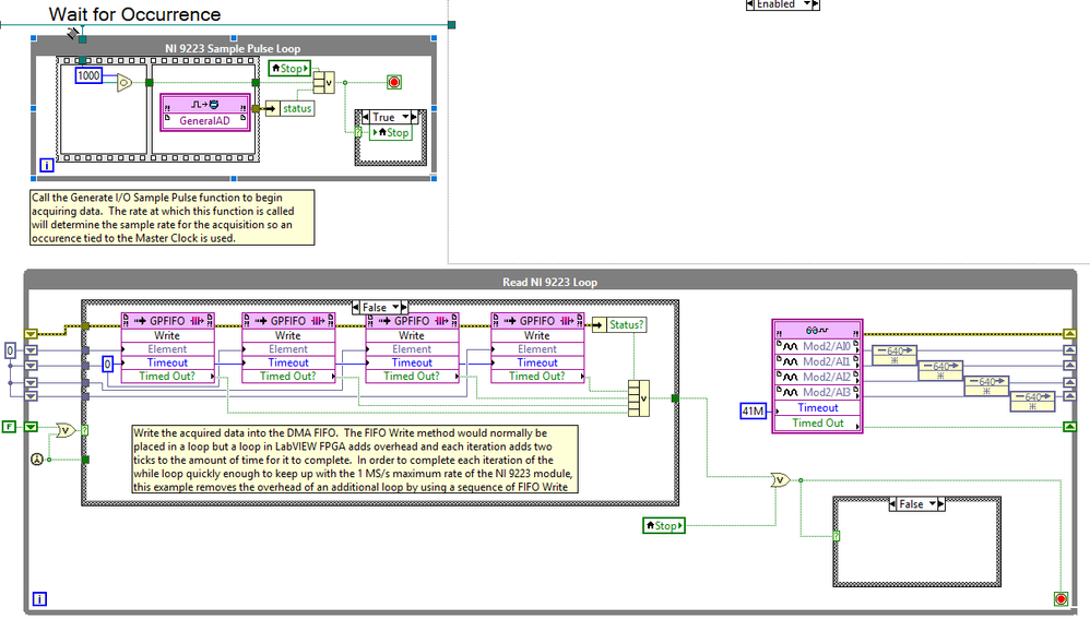

Next I have two loops for my SAR acquisition. Since I am acquiring data at a high rate, I am using the Sample Pulse method. For lower rates this is probably not needed. Note that the pulse that starts sampling for the SAR module are tied to the occurrence. You will need to do something similar for your application. Have a separate loop where the sampling waits until the occurrence.
Note the delay is still needed, as there is a delay for each channel acquisition.
