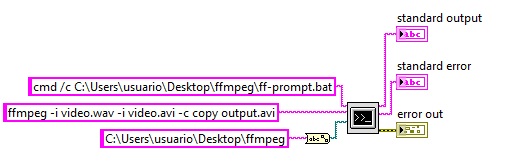

I'm trying to merge audio and video previously adquired in labview, and I can do it with the FFmpeg tool by typing
"ffmpeg -i video.wav -i video.avi -c copy output.avi" on the FFmpeg console.
I would like to do it programatically, so I think I need to use the System Exec Utility. I have tried this:
But it does nothing. I think I'm not setting the input line correctly. Do I have to set the command in the Standar Input as I do in the command line from the FFmpeg Console?

Perhaps you could try testing System Exec.vi using simple commands.
Read this link: http://digital.ni.com/public.nsf/allkb/8E19CA81874FFDD786256BE40066C151 , I believe there are 2 screenshots which shows 2 different methods of writing command using system exec. What I can see from your screenshot is that you're using both at the same time. Can you try using the method found in the link (1st screenshot) instead?
Here's an example which you can refer to and play around with: https://decibel.ni.com/content/docs/DOC-1109
