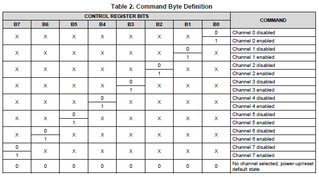

Writing a value of 1 to the control register doesn't open channel 1, it opens channel 0. To open channel 1 you need to write the value 2. The eight channels are mapped to the eight bits in the control register.

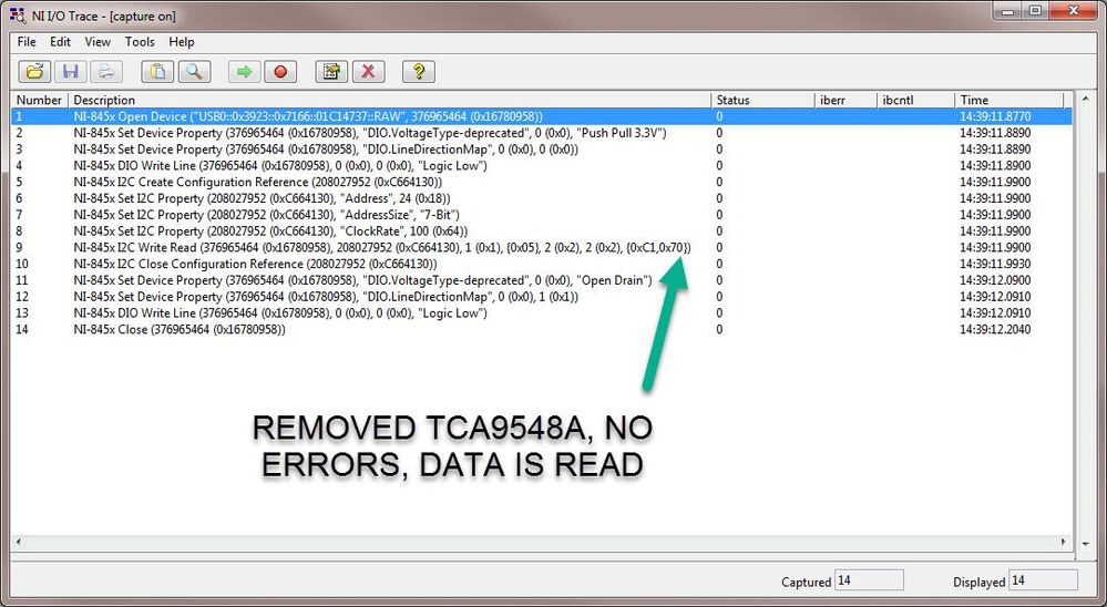

I think the TCA9548A is supposed to take a MASTER SDA and SCL from the USB-8451, then switch to a channel PORT.  This way I will only have one active PORT open at a time.  I'm not trying any other i2C on the bus right now, I only have one connected.  My hope is that I can have multiple i2C devices with the same address and switch to one port at a time using the TCA9548A.
Can you think of any other ways of checking these values in NI I/O trace?  See my attached NI IO traces...with TCA9548A code and with TCA9548A removed.
NI-IO-TRACE WITH NO TCA9548A.jpgNI-IO-TRACE WITH TCA9548A CODE AND FAILED READ.jpg

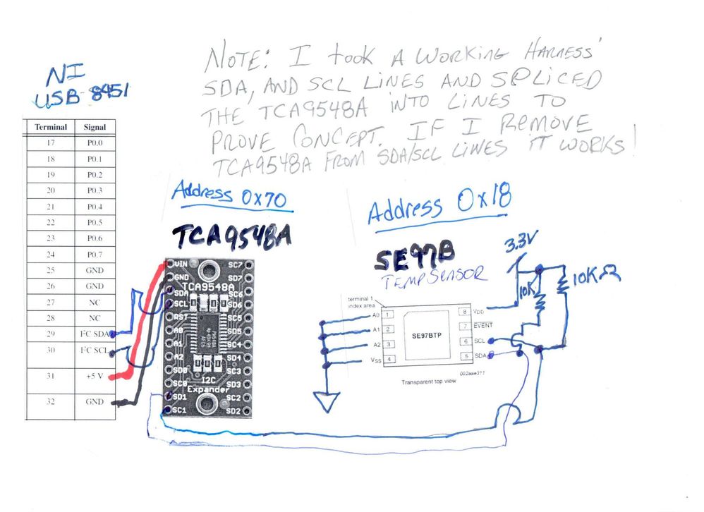

Unfortunately I don't have any experience with the USB-8451, but I do have experience with I2C. You're correct about what the TCA9548A can be used for; you should be able to connect any or all of the eight channels to the master by sending the chip the appropriate command, allowing you to select between multiple devices with the same address. Can you share a drawing of your circuit so we can make sure the TCA9548A is connected correctly?

Here's a crude drawing I did by hand to help illustrate how I have it hooked up.   I'm thinking I should be able to do this sequence:
1)  Address the TCA9548A at the default address 0x70.
2)  Write a Channel Number to the TCA9548A and the channel or port then becomes open to i2c commands.
So far I can verify I'm reading and writing values to the TCA9548A
3)  At this point, my belief is after the channel or port is open, then I can address other i2C on the port that is open.  When I try to read the Temp Sensor SE97B at Address 0x18, I get nothing.
After I open the port/channel on the TCA9548A, do I need to address the SE97B differently than the original address of 0x18?  It's no longer a direct connect, but, it goes through the TCA9548A.
Thanks again for looking this over for me!

Does the USB-8451 have built-in pull-ups on its SDA and SCL pins? From what I've been able to find it looks like no. There need to be separate pull-ups on all of the TCA9548A's I2C ports, as well as on its RESET# line. With the SE97B connected directly to the 8451, the 10k resistors you show will pull the I2C bus between the SE97B and 8451 up to 3.3V. But with the TCA9548A in between, if you're powering it from 5V like you show, then you'll also need separate pull-ups to 5V on its SDA, SCL, and RESET# pins. Regarding #2, again, you don't write a channel number to the TCA9548A, you write a 1 to the bit corresponding to the port(s) you want to enable. Once the port is enabled you can talk to the device on it just like you would if it were directly connected, no special addressing needed.
