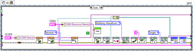

I am using a PXI chassis with an MXI card, and synchronising a PXI-5122 digitiser with a PXI-5412 FGEN using NI-TClk.
I configure the TClk session in the conventional way (I think!) as so:TClk question 3.png(Apologies for the broken wires - I tried to take a snippet of a bit of my VI rather than the whole lot, which I unfortunately can't release.  However, it works fine so no need to worry too much about it!)

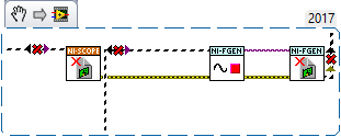

Then the program runs, and works fine, and then at the end I release the devices as follows:TCLK question2.png
And this also works fine.
The bit that doesn't work is if a user sets a combination of settings that aren't allowed, for example capturing more samples than is possible with the onboard memory.  Then, despite the fact the snippet above still runs on exit, I am unable to use the cards again without shutting down the computer and re-booting it.

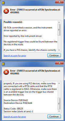

The error I get then comes from the "niTClk Sychronise.vi" and says:NI TClk problem.png
