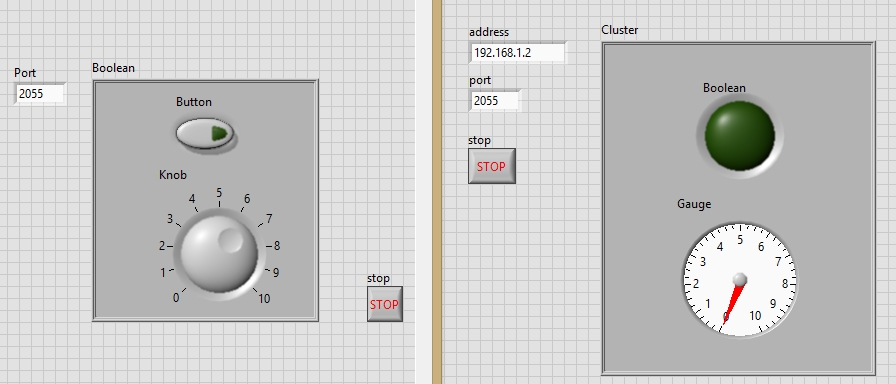

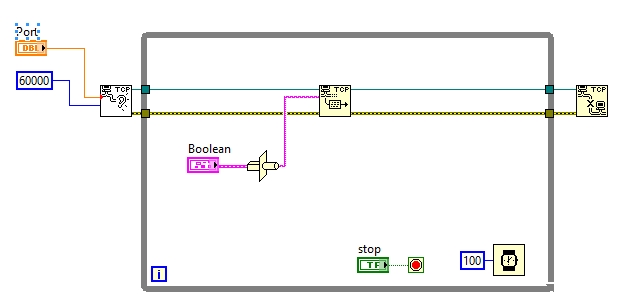

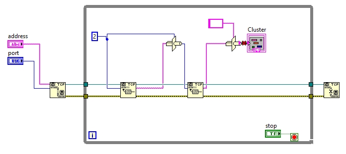

Hi everybody,
I'm studying about TCP / IP and make an example but it is not yet operational. Therefore I'm looking forward to receiving the help.
Fig.1: Server
Fig.1: Client

Copy the server Boolean cluster and paste it in the client where you are passing the "string constant". Also don't define the size of 2 bytes, you may endup missing data. From the server first send the size of the data to the client and then send the actual data.

Create a cluster constant(check in the cluster palette) and then take 2 numeric DBL constant and select them and drag them into the cluster constant. Then Take two false constant pull those guys as well into the cluster constant. Right click the cluster constant and go to the Auto sizing and select arrange vertically. Are you getting what you expected? Please go to my profile (click my name not the kudos) and go to Tags there you can find LV basic, click that you will find LabVIEW basic materials, please go through them (I am not able to give you the link, since posting from mobile).

It's clear that you looked at the shipping examples but it's also clear that you did not understand them. The whole purpose of reading two bytes and using that got the next read is that the example is pretending (with 2 bytes), the size of the data being sent. Your server does not do that so your read will fail.
It also does not make any sense to create a cluster with four elements. The cluster you have only had two elements. Focus on fixing the server.
