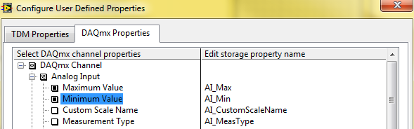

Now, even some of those data writers think those properties are fairly important.  If you look under the advanced section of the "Write to measurements file" Express vi configuration wizard.  a lot of the common properties may be selected for "automagicilly" being added to the TDMS file
This is probably what you are used to seeing happen in someone else's existing code.
