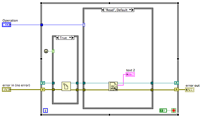

Thanks for the replies,
Here is a stripped down example.  I don't think the VI is going idle since I'm not closing it.  However, I am just running it by itself, selecting an action and then hitting the run arrow (i.e. it's not a subVI within a main VI that is constantly executing).  I thought that would maintain a valid reference and it seems to since I get no error closing the TDMS file, just when I try to read or write data or properties.

I think what you should investigate is an auto-initializing Action Engine. This is a tried-and-true technique that will work when used as a subVI or when called by itself. The idea is to use the First Call function to determine if you need to initialize your data structures, such as the TDMS file reference, rather than having a specific Initialize case in the Action Engine. That way, the first call to your Action Engine opens the file, regardless of which operation you're doing (Read, Write, etc). So you know you're always working with valid, initialized data.
This works for the case when you just press the run arrow everytime, since everytime you do that is the first call. When used as a subVI, there's only one first call, but you don't need to reinitialize your TDMS reference since LabVIEW won't clean it up unless the Action Engine VI goes idle.
I've attached a dummy example to help out. It doesn't do anything interesting, but should get you started.
