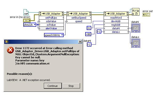

I begin build application, but when run it then error 1172 appears.
How I can define object?
"Error calling method USB_Adapter_Driver.USB_Adapter.setPullUps of NULL ObjectId, (System.ArgumentNullException: Key cannot be null.
Parameter name: key ) in HFE communication.vi"
Message 9 of 15
(9,699 Views)
You need to open (instantiate) the .Net object before you can attempt to do anything on it. As it is now you try to operate on a NULL object meaning there is nothing to perform your methods on. Look at the .Net Constructor node.
