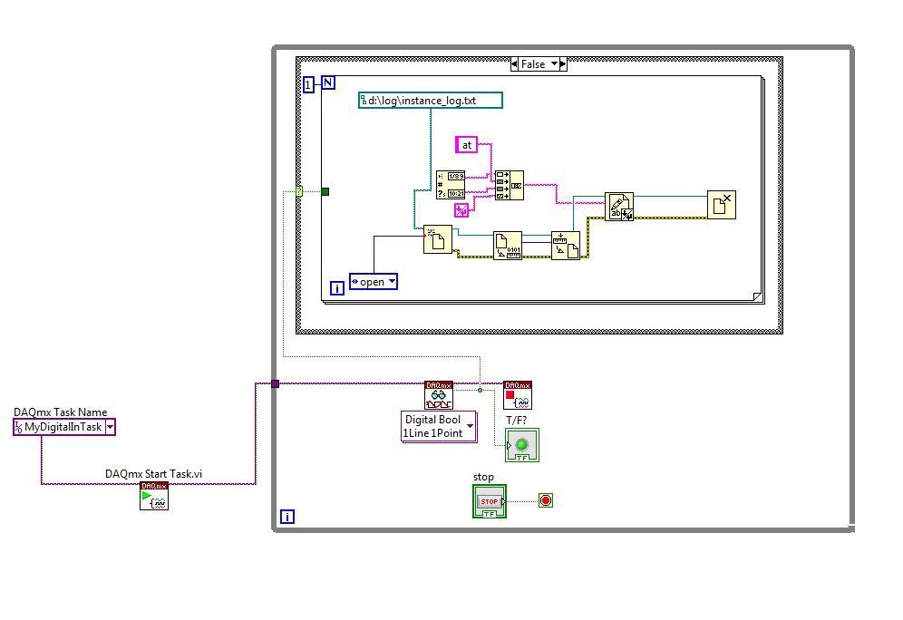

I'm trying to trap and record the event whenever the emergency stop button is pushed on a particular machine. The VI I created does do that but the problem is that it continuously writes into the file while the emergency stop is engaged (False condition). I am trying to record only the first intances, but being completely new to Labview, I am struggling a bit. Any help would be greatly appreciated

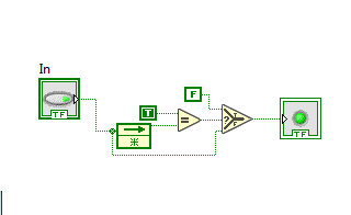

With this simple structure you can convert the continuously true output in single true output
with this you can remove che chase structure and convert the boolean output to (0-1) for control directly for loop

First off get rid of the For loop, it's not doing any good. Second, either use a feedback node (like Diell said) or a Shift register.
You want to compare logic states- you want to trigger the write if (Value = True) AND (LastValue = False)
Comparing a Boolean with true is redundant.
If a==true then b= false else b=c is basically a=!a and c
This reads better. If Boolean is true and previous Boolean is false, result is true.

Still can't work out where this fits in. I tried it as the input to the True/False loop, but the input to the file remains continuous

Time to post your updated VI.
The shift register should go between the DAQ read and the case structure (NKA True\False loop).
