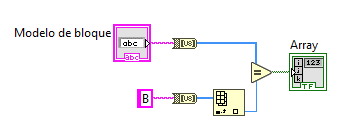

you mean to do like this?

Getting there. It's simpler than you make it.
On the "B" string, converted to the array, get the first element (Index Array).
The result of the Equal is a Boolean array, so it will fit the Boolean array indicator.
