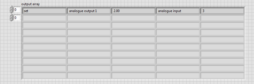

At the moment this VI does not recognize "/n" and is causing an undesired result:
I would like the VI to start a new row every time it parses /n. It would also be nice to have the flexibility of commenting "//" in the file which would be ignored when reading. Would you have any ideas of dealing with that?

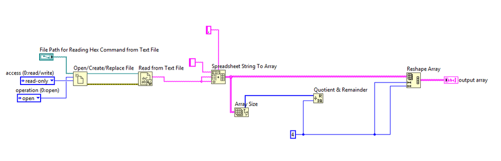

Alright Thanks Crossrulz, is the alteration below using best practice functions. Also not sure how to get around ignoring comments "//" in text.

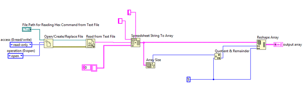

This might be a little simpler
Message 6 of 8
(4,179 Views)
The formatting you've illustrated has achieved the desired result.
