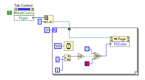

Blinking is just a timed color change. Once you allow multiple colors, you can do the following:

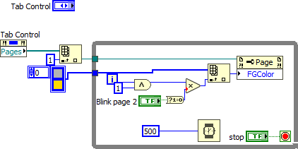

Alternate option:
Allow different colors per page, then toggle the color of the page that needs attention if it's not selected.  Not as simple as setting a "blinking" property and being done with it, but should work.

Thank you both, for your ideas!
This changes the color for the entire page, and not just the tab, though.
And it's actually clumsier than using a boolean indicator on the tab. But I'll keep this in mind if I need it.

Note that my while loop can be be completely separate from your toplevel loop and runs in parallel for the duration of the program. For simplicity, it could have an event structure where the blinking is done in the timeout event and selection with another event. Also create an event for the main stop, no local variable needed.

Also, your method does not work if the other page is active. That is a crucial requirement.

So is the goal to notify the user that something on that tab needs to be looked at but not actually go to that tab?
Are replying to any particular post, because we cannot tell what "your method" means here.
I also don't know what you mean by "active". My code should work no matter what page is visible.

Here's a way to do it.
