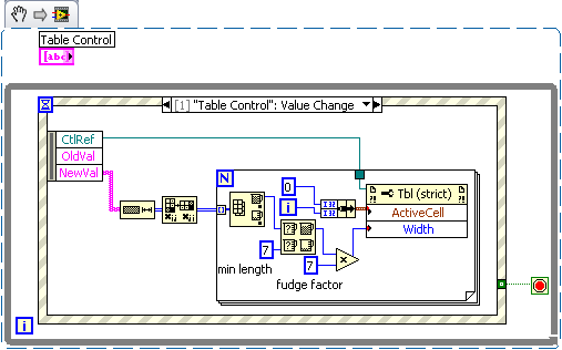

Since you would end up scanning the entire table anyway to find a changed value, why not autosize the entire table whenever a value is changed.  Here is a quick example.  I was lazy and just set the size to 7*length, you could tweak to get a reliable text length to width conversion.
I haven't patched LV2009 yet so trying to save for LV8.2 is going to either crash my LV or require too many steps for me right now.  I think you get the idea.
