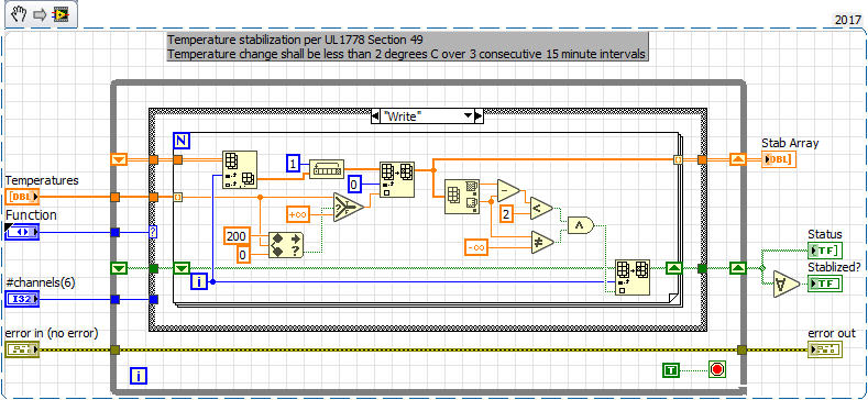

Well we use a different standard for stabilization here per UL1778 Section 49 "Temperature change shall be less than 2 degrees C over 3 consecutive 15 minute intervals" and I created an "action engine" to test for it.
You feed it a numeric array containing your measurements every 15 minutes to test for stabilization
You might have to change the High and Low limits depending on your application in the "Write" state.
I use this in a program for thermal testing power transformers and use redings outside of 0C and 200C as open thermocouple detection.
