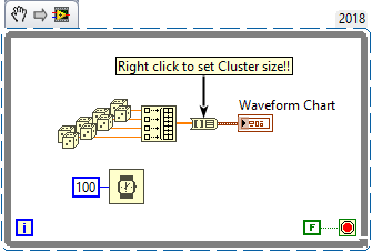

That isn't too much off from what you have.
But as your dT is constant, you probably don't need to keep the time at all.
A chard will take an array of (scalar) points, and keep history on it's own. So you also won't need to keep an array of history.
GerdW might cook up something. (EDIT: That crossed) (BTW: Do you know about kudos?)
