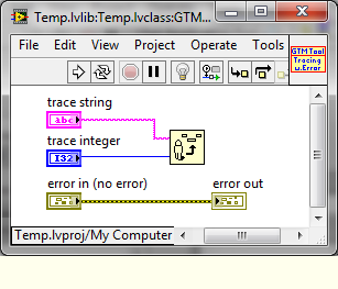

I've added some instances of the 'Generate User-Defined Trace Event Function' to get the trace of functions. As this node does not have an error chain I've wrapped it with a simple VI that provides such error chain. Makes it easier to enforce execution sequence...
That wrapper VI is stored in a subfolder of user.lib
HOWEVER: When I run this program with the wrapped VI it crashes. But if I put the 'Generate User-Defined Trace Event Function' node in a sequence it does NOT crash...

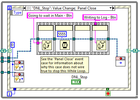

This is basically the template code that is generated when creating anew project with Actor Framework. I wanted to study the Last Ack Message functionality, so in one of the nested actors I modified the Stop Core.vi to insert a message '<Stop received at date&time' into that actors private data (a field My_msg added). In the main actors Actore Core.vi I modified the evet handler loop:

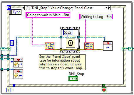

AFW_1.png  If I insert a wrapper like this: AFW_2.png, the event handler looks like:AFW_3.png
And this one crashed when being run, at least in conjunction with desktop trace execution.
